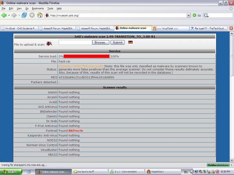

ya it is through tis site that i found out that the CE have tis file inside ...
the 1st site only gave me info that it is infected wif RKProc!tr ..... i post a ss la .... as i lazy to rescan ...
as i think the 1st one will not be of much use .... i scanned using the 2nd one as well ... results here~~
Antivirus   Version   Update   Result
AntiVir   7.2.0.31   10.20.2006   no virus found
Authentium   4.93.8   10.20.2006   could be a corrupted executable file
Avast   4.7.892.0   10.19.2006   no virus found
AVG   386   10.20.2006   no virus found
BitDefender   7.2   10.20.2006   no virus found
CAT-QuickHeal   8.00   10.19.2006   (Suspicious) - DNAScan
ClamAV   devel-20060426   10.20.2006   no virus found
DrWeb   4.33   10.20.2006   no virus found
eTrust-InoculateIT   23.73.30   10.20.2006   no virus found
eTrust-Vet   30.3.3143   10.19.2006   no virus found
Ewido   4.0   10.19.2006   no virus found
Fortinet   2.82.0.0   10.20.2006   RKProc!tr
F-Prot   3.16f   10.20.2006   no virus found
F-Prot4   4.2.1.29   10.19.2006   no virus found
Ikarus   0.2.65.0   10.20.2006   no virus found
Kaspersky   4.0.2.24   10.20.2006   no virus found
McAfee   4877   10.19.2006   New RootKit
Microsoft   1.1603    10.20.2006   WinNT/Rootkitdrv.gen!A
NOD32v2   1.1818   10.20.2006   no virus found
Norman   5.80.02   10.19.2006   no virus found
Panda   9.0.0.4   10.19.2006   Suspicious file
Sophos   4.10.0   10.15.2006   Troj/RKProc-Fam
TheHacker   6.0.1.101   10.19.2006   no virus found
UNA   1.83   10.19.2006   no virus found
VBA32   3.11.1   10.19.2006   no virus found
hope is yet to be found ....

file type???
« Reply #5 on: October 21, 2006, 10:25:36 AM »
I take it you haven't ran the file on your computer yet?
I would delete the .rar
I wouldn't take the chance to run it, it has rootkit possibilities
Maybe not just to hide cheat engines but may allow open doors for other malware onto your computer
Where did you download this file from
Here at this forum?
Can you give me a link to it please
You can delete blbeta.exe and the log
